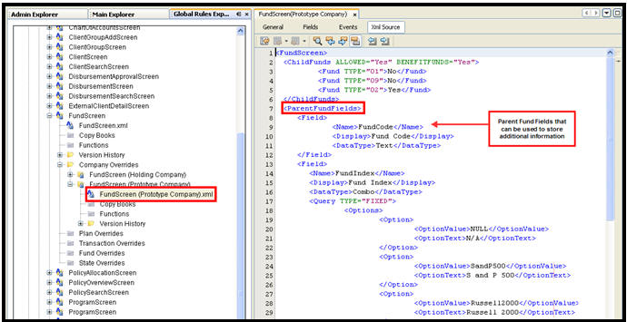

  1. Open the new override rule in the Configuration Area and click the XML Source pane.
  2. Configure the <ParentFundFields> element directly under the opening tag.
  3. Add a <Field> element for each field that is needed for parent funds. Please see the XML Configuration Guide topic in this help system for a list of all elements, attributes and values needed for configuration. View Common Elements | Field Elements.
  4. Right-click on the FundScreen.xml file and select Check-In.
FundScreen Business Rule with ParentFundField ElementFundScreen Business Rule with ParentFundField Element

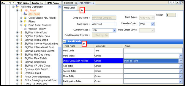

The image below shows a fund open in the Configuration Area. Section A contains the fund details, which are stored in AsFund and captured through the Fund wizard when the fund is first created. Section B shows the fund fields that were configured in the FundScreen business rule. The user enters information on the screen and when saved it is stored in AsFund.
Fund Details of Fund in Admin ExplorerFund Information from Admin Explorer Funds Node
